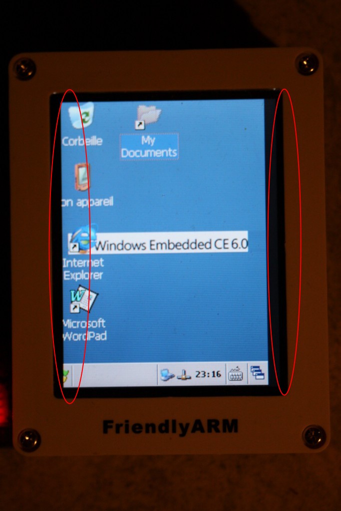

Everytime I'm building a WinCE image with Platform Builder, the screen alignment is incorrect.
If I use provided prebuilt image, it works well.
I have the exact same problem with WinCE 5.0 and WinCE 6.0, with sources from andahammer or latest WinCE6 from esky...
Here is an attached photo of the problem.
I guess I miss some configuration... but what ?
Thanks in advance for your help
Ce shifted.JPG (103.28 KiB) Viewed 3622 times

You have to set the screen options.
Search for the line
#define LCD_T35
You need to choose between
#define LCD_N35
or #define LCD_T35
(Uncomment out only one) and rebuild.

Thank you !!

yes , i had the same problem. and i chose the ..T35... file than everting is ok
