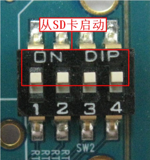

First question, there is a 4-switch on the board to control
the boot. I didn't find the meaning of this switch in the PDFs coming with
the CD, I placed the switches 1 and 2 at off and the switches 3 and 4 at
on, they were like this when the board arrived, is it correct ?

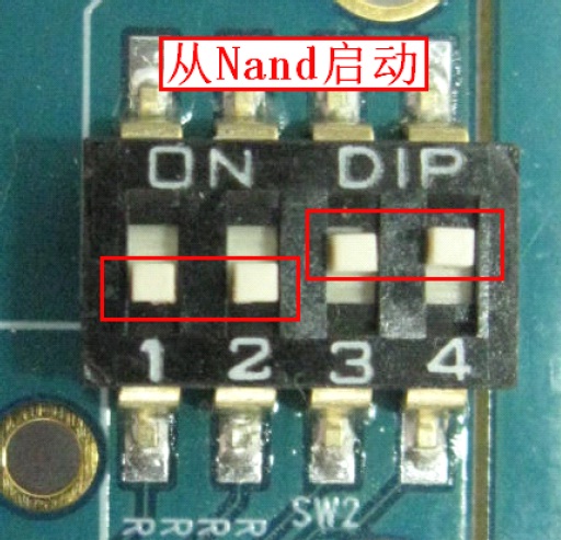

Do you
have a document with their meaning ?
1. Nand boot mode:
"0011"
2. SD boot mode:
"1111"
3. Nor boot mode:
"0101"

3. Switch to nand boot mode and power cycle - Done succesfully

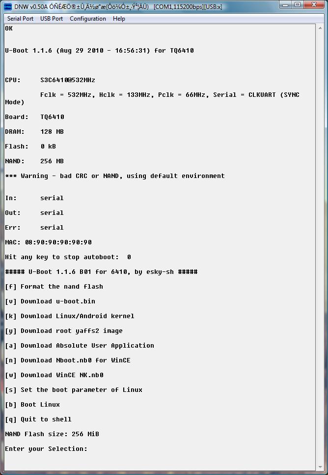

So I did the following (I have a TQ6410 with the 7 inches screen):

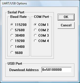

- Go into DNW.exe and choose the options 115200, COM 1 and 0x50100000 for UART/USB. (Picture 1)
- Connect to the serial port and power on the board in Nand boot mode, then press on a key to see the menu. (Picture 2)

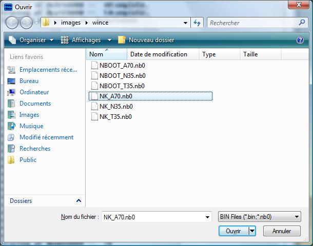

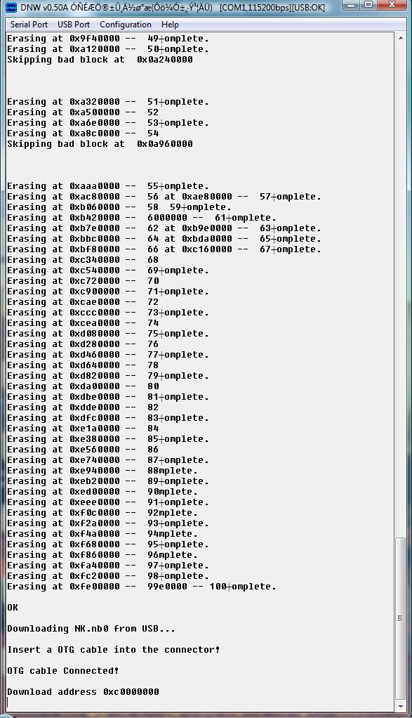

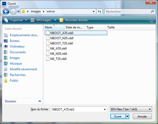

- Press on n (- Download Nboot.nb0 for WinCE) and transmit through USB the file D:/images/wince/NBOOT_A70.nb0 present on the DVD. (Picture 3)

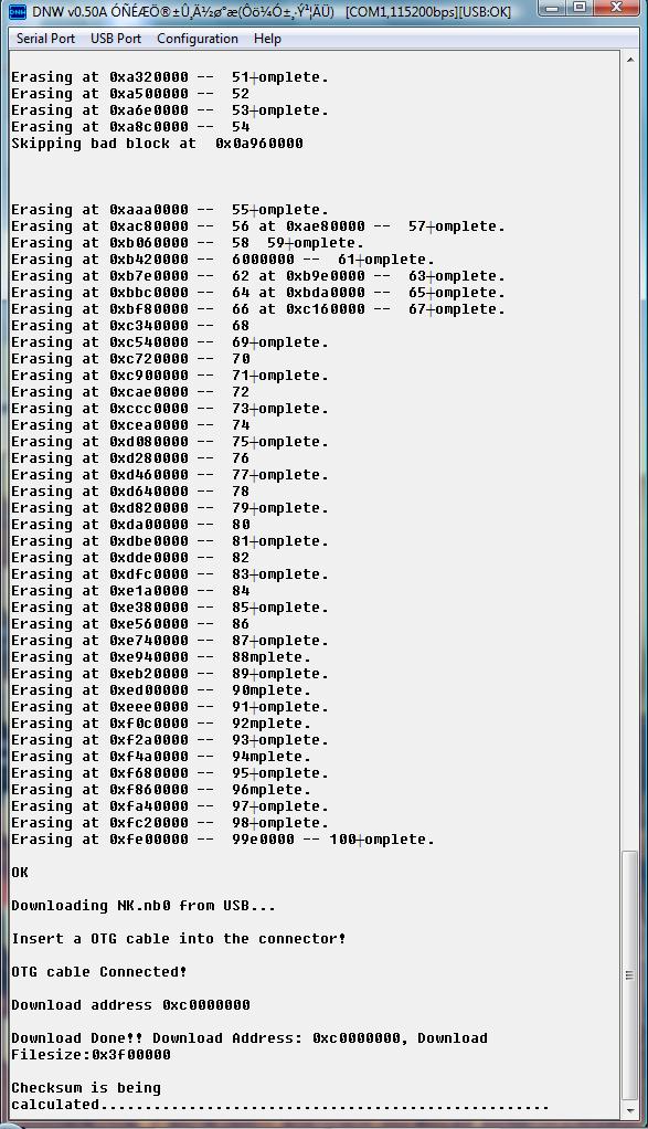

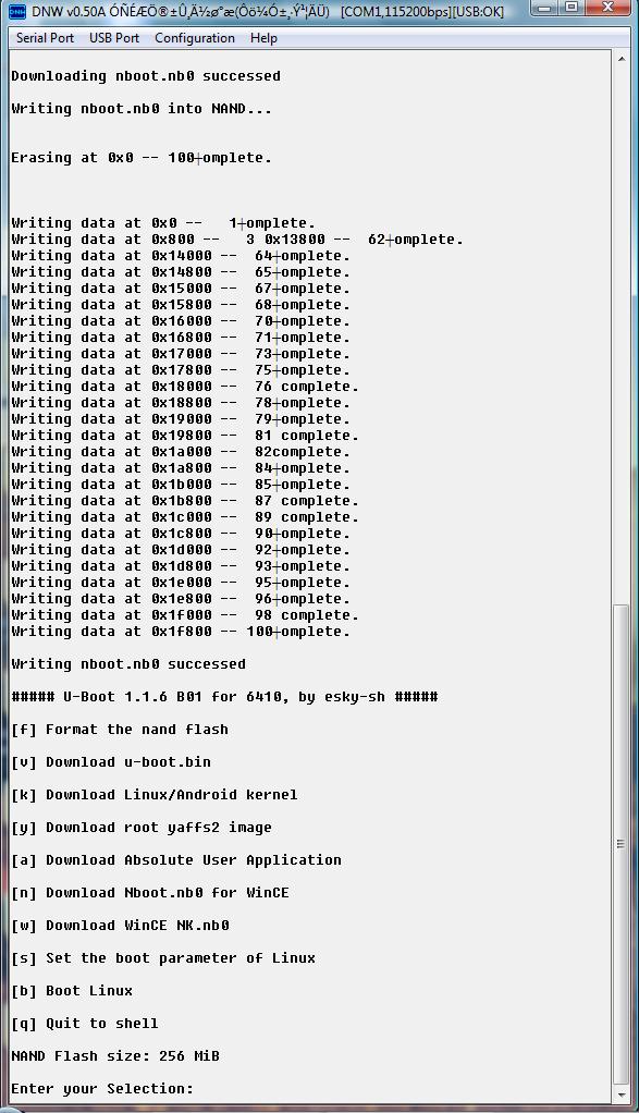

- The writing was apparently succesful as seen on (Picture 4)
- Then I pressed on w (- Download WinCE NK.nb0) (Picture 5) and transmit through USB the file D:/images/wince/NK_A70.nb0 present on the DVD (Picture 6)

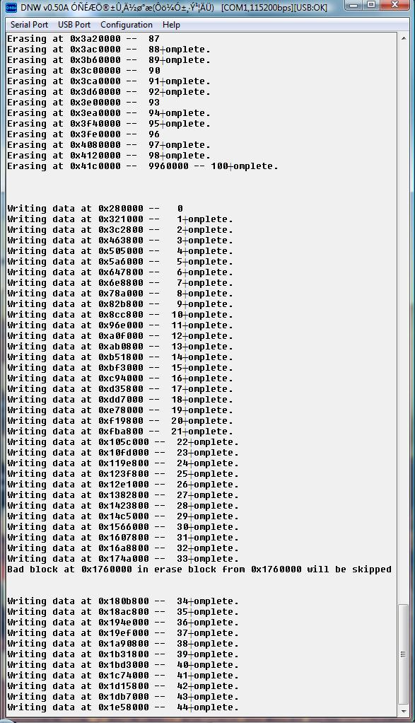

- This gave me (Picture 7) then (Picture 8) where I can see there is a bad block then (Picture 9) where I can see there is another bad block and finally (Picture 10) where all seems completed.

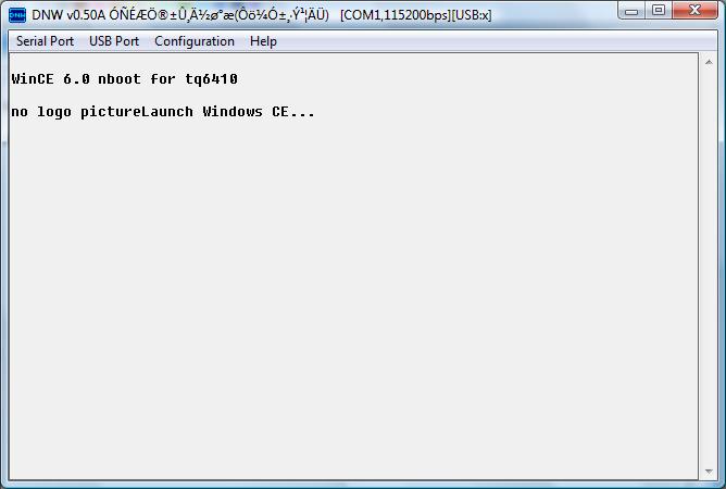

- Then I power off the board and then I power it on again and get the following message (Picture 11). After some seconds, I finally get the message (Picture 12) and then nothing.
The LCD screen doesn't emit light and there is nothing more happening from this step.

Re: 2 common questions for wince installation on TQ6410
Post by esky-sh » Tue Nov 16, 2010 12:31 am
seems like wince lanuched successfully but you have problem with your LCD displaying, according your pictures and description.
you can double check the LED blinking on your TQ6410 board, either you can ping to your TQ6410 board by ethernet port. Wince should work normally already.
right now we should figure out the reason why 7"LCD not display.
do you have any other LCD display like 3.5"?
