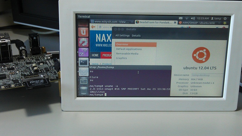

Post by esky-sh » Sun Aug 26, 2012 12:13 am
Precise Pangolin (12.04) Installation Instructions
Post by esky-sh » Sun Aug 26, 2012 12:57 am
1. Install Precise Pangolin (12.04) on your Pandaboard or Pandaboard ES
https://wiki.ubuntu.com/ARM/OmapDesktopInstall
2. Apply all the current Ubuntu updates and reboot.
apt-get update
apt-get upgrade
3. Install kernel debs for Beadaframe supports
dpkg -i linux-headers-3.2.0-1412_3.2.0-1412.16_armhf.deb
dpkg -i linux-headers-3.2.0-1412-omap4_3.2.0-1412.16_armhf.deb
dpkg -i linux-image-3.2.0-1412-omap4_3.2.0-1412.16_armhf.deb
4. Flash kenel images to boot section and reboot
flash-kernel
Precise Pangolin (12.04) TI_OMAP_PPA Installation Instructio

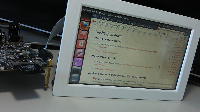

Post by esky-sh » Wed Aug 29, 2012 12:16 am
1. Install Precise Pangolin (12.04) TI_OMAP_PPA on your Pandaboard or Pandaboard ES
https://groups.google.com/forum/?fromgr ... ha5A2JIS1c
2. Install kernel debs for Beadaframe supports
dpkg -i linux-headers-3.2.0-1485_3.2.0-1485.7_armhf.deb
dpkg -i linux-headers-3.2.0-1485-omap4_3.2.0-1485.7_armhf.deb
dpkg -i linux-image-3.2.0-1485-omap4_3.2.0-1485.7_armhf.deb
3. Flash kenel images to boot section and reboot
flash-kernel
