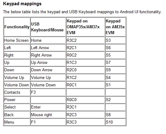

Here is a keymap taken from TI Wiki
Post by esky-sh » Thu Jun 16, 2011 12:04 am
http://processors.wiki.ti.com/index.php ... _UserGuide
