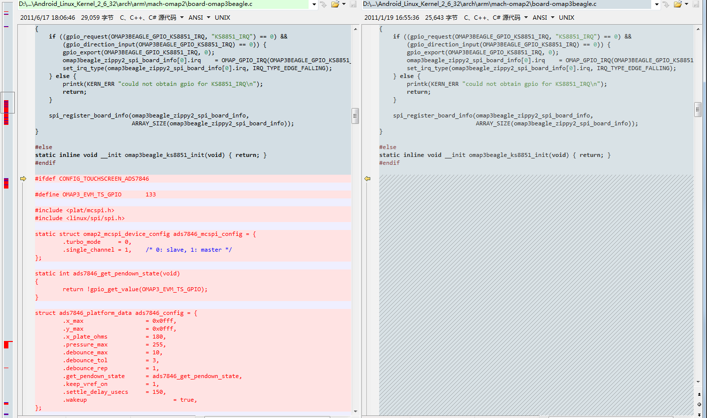

Hi, I am a beginner and I know there are some differences between Rev C4 and xm, but I tried to make this LCD working with Rev C4 and Android rowboat 2.3.4.
I have used your pre-built images and the display did not work. I made some changes in video driver, luckily it works. However, it really differ from your changes for display.
For touchscreen, I have read your source code and found some changes in ads7846 driver, and I changed it like your source, but I cannot touch anything like at the beginning.

Updated it finally works
Here is the patch: http://bit.ly/touchScreenPatch
and the tutorial is here ( http://bit.ly/sk4t3Q) , hope it useful for you. Good luck

Generally you may need to check with pin mux and spi configuraiton to ensure the driver can work well with the hardware.
I suggest you add some printk to find the content of pin mux registers. Of course you need to ensure the SPI was configured inside linux kernel.

Now the touchscreen is recognized when booting:
spi3.0 supply vcc not found, using dummy regulator
ads7846 spi3.0: touchscreen, irq 293
input: ADS7846 Touchscreen as /devices/platform/omap2_mcspi.3/spi3.0/input/input1
when use "getevent":
add device 1: /dev/input/event1
name: "ADS7846 Touchscreen"
However, when I touched in the screen, it is not caught any event. It is so confused, am I configure SPI and pin mux wrong ? What may cause the problems ?

The reason may be the problem in configuring touch sensor to SPI 3.0 ( as following link http://e2e.ti.com/support/embedded/f/509/t/132452.aspx )
However, I do not know how to do it.

Finally, this touchscreen works with Beagleboard Rev C4 using rowboard Android GingerBread 2.3.4 !!!
@matt13: you need made some changes with board-omap3beagle.c, config file and ads7846.
