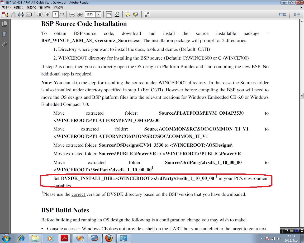

Post by esky-sh » Sun Nov 20, 2011 9:38 pm
TI is assuming your %WINCEROOT% is C:/WINCE700.
If your %WINCEROOT% point to somewhere else, e.g. E:/WINCE700 in this example, manually changing in PB2008 envoirnment needed then:
