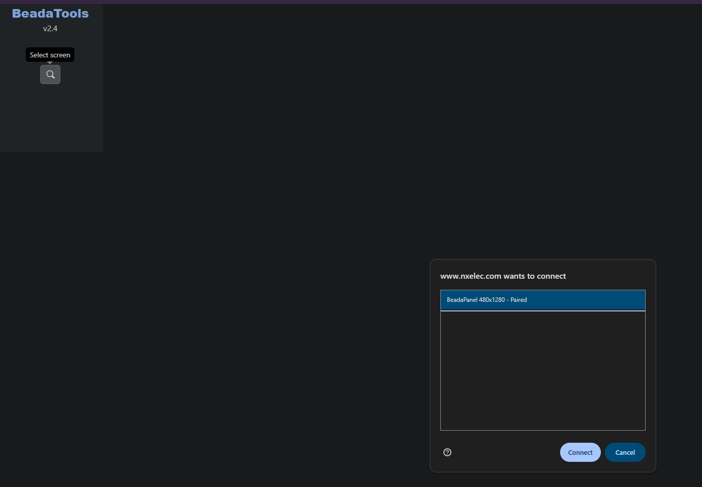

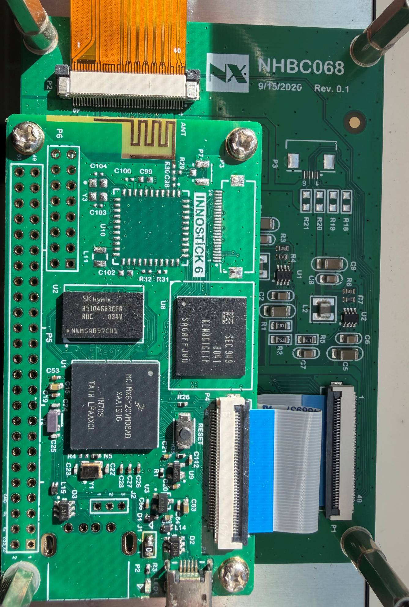

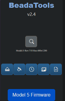

Hi... need some help with my Baada panel. In short, regardless how many times I reflash my panel, beada service tool senses my panel as a Model 5 instead of 6 but yet the resolution is noted properly. With that said, it leads to Win11 also detecting the panel as a Model 5 and subsequent software (AIDA, InfoPanel) get the Model 5 and its associate resolutions (which do not match my actual screen).
I attached some images that I hope help. Any assistance is very appreciated.

I had tried that prior because I had seen the same post you sent and I tried again just now to make sure to flash both partitions. Unfortunately, I have the same outcome. Beada Service Tool still sees as a Model 5 (but model 6 resolution). Any thoughts, is there a different process for the my model?

Re: Beada 6.8 in weird issue
What is the firmware version showing on Beadatools?
tuftybruno
- Posts: 4
- Joined: Wed Nov 12, 2025 11:33 am

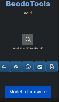

It shows 7.10 after flashing. I am able to upgrade to 7.18 but still notes as model 5 (sent in previous screenshot).
Thanks!
Not sure if relevant, in win11 device manager the device Hardware Ids are:
USB\VID_4E58&PID_1001&REV_0718
Based on quick research I believe the NXElec is suppose to be: VID_1FFB
Thanks!
- Beada 710.png (11.14 KiB) Viewed 29439 times
Looks like your environment was polluted seriously by some mis-operations and a normal reset can not recover it. We will provide a whole eMMC image to let you rewrite the device. Will let you know soon.tuftybruno wrote: ↑Thu Nov 13, 2025 12:18 pmIt shows 7.10 after flashing. I am able to upgrade to 7.18 but still notes as model 5 (sent in previous screenshot).
