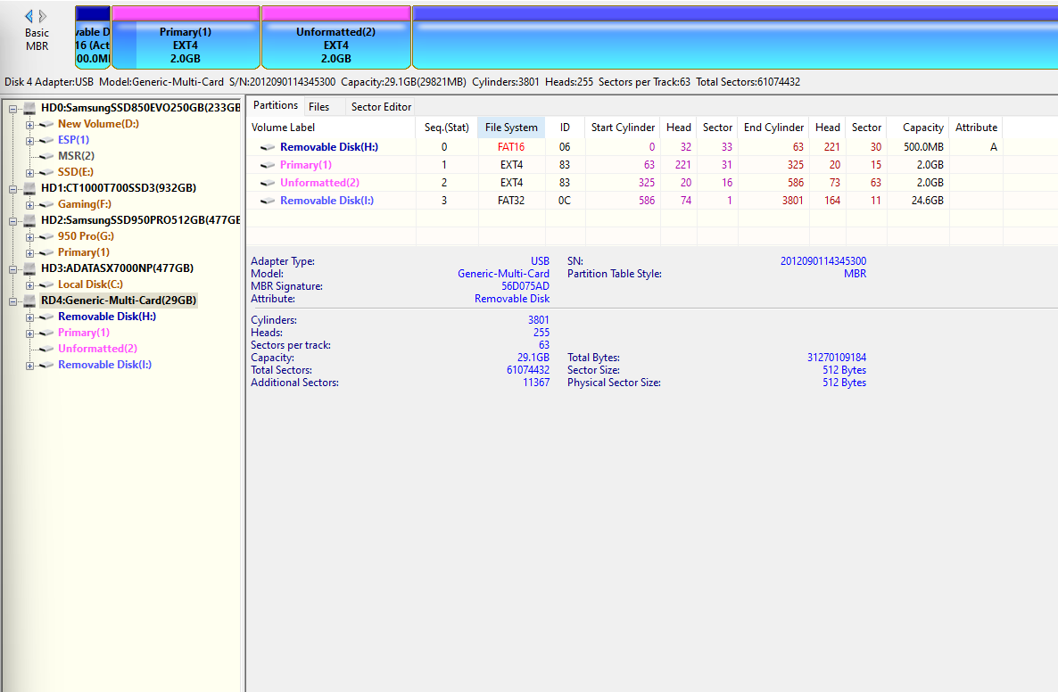

Okay I downloaded the files and manually put the two zImage file and .dtb file in the parent directory for the FAT16 drive. Restarted PC and replugged USB, panel no longer flashing LED, no backlight still. It's as if the USB port does nothing at all when connected to the panel.
Previously when it was flashing the screen on and off with the blue LEDS it was showing the device as an unknown device in OTHER DEVICES in my device manager but it doesnt even show up there. Like I said, it's as if the USB is never even connected to the device no matter which USB I use.
I attached photos so it should be clear I confirmed it is the FAT16 drive I put those files in and plugging it in still does nothing when plugging in or show in device manager. :cry:

Post by esky-sh » Mon May 19, 2025 3:34 am
As I already mentioned, please follow this procedures for further troubleshooting. https://www.esky-sh.com/bbs/viewtopic.p ... 1120#p3946
