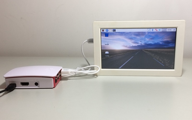

BeadaPanel is a versatile media display. It can playback images and videos in various common format. In this application, BeadaPanel is used as an USB monitor/display for Raspberry Pi mini PC.
Pre-requirements
  • A Raspberry Pi mini PC
    A BeadaPanel display kit
    A Micro USB cable
Procedures
1. Power on your Raspberry Pi mini PC
2. Connect BeadaPanel to Raspberry Pi by a Micro USB cable
3. BeadaPanel will be automaticaly recognized as a USB mass storage device by Raspberry Pi

4. Locate and run beadapanel deamon in /media/pi/boot/bpd folder
Code: Select all
pi@raspberrypi:~ $ sudo cp /media/pi/boot/bpd/bpd /usr/bin
pi@raspberrypi:~ $ sudo chmod +x /usr/bin/bpd
pi@raspberrypi:~ $ sudo bpd
BeadaPanel Daemon Ver. 1.0
5. Run beadapanel deamon from booting
Code: Select all
$ sudo nano /etc/rc.local -> add new line before "exit 0" with "/usr/bin/bpd &" without quote
$ sudo reboot
