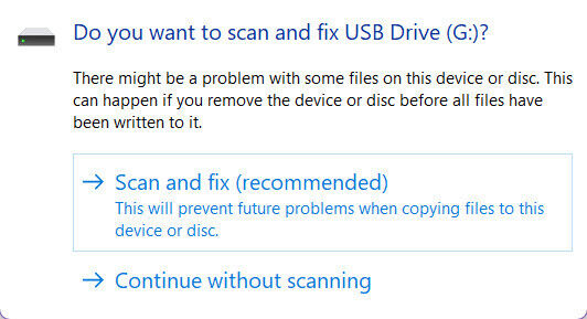

Q: Every time I run BeadaTools, I get the "There is a problem with this drive" pop-up, and it asks me to scan and fix the drive. I haven't done that yet... wanted to check with you first. (2nd and 3rd pics).
A: Please ignore this Windows message. Either of choices makes no difference to BeadaPanel internal storage memory.

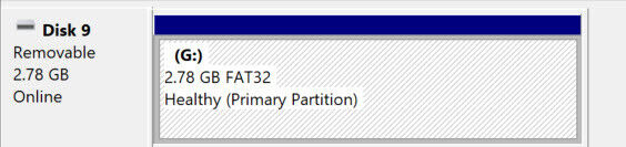

Q: Website says this panel is supposed to have 8GB of eMMC storage... I only have 2.78GB (4th pic). Shows the same, both in Explorer, and Disk Management. Is this correct?
A: BeadaPanel has four partitions on this internal eMMC(500M/2G/2G/2.8G). The last partition(2.8G) is for album function and that is the only partition exposed to your Windows Host.
