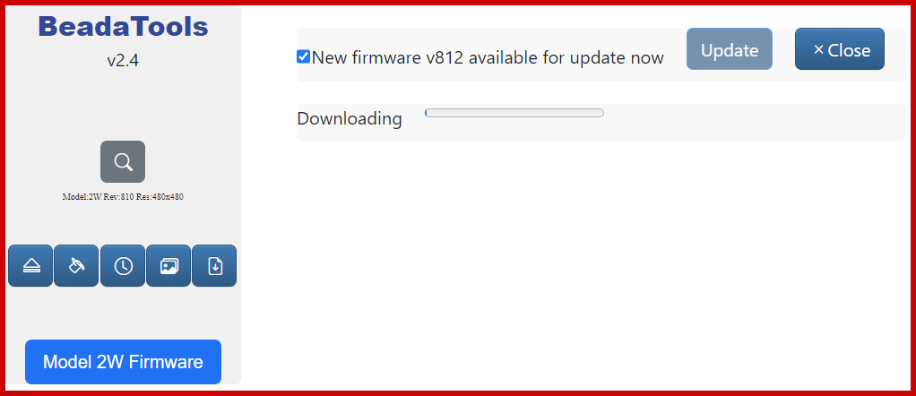

Currently on FW 8.10... using the BeadaPanel Service Tool, it shows there is no FW update available (see screenshot).

Good morning,
The Service Tool now recognizes that there should be a firmware update...
But it does not download... three attempts:
1. Sat at "Downloading" for 15min, never got past 5%
2. Reboot, try again... after one minute, message "Failed to Fetch" in the status section
3. Click update again... same as #1
Re: BeadaPanel 2W - 8.12 firmware not available?
Post by esky-sh » Mon Apr 22, 2024 4:17 am
Usually it was caused by poor internet condition. You can try update locally. Here is the image file https://www.nxelec.com/service/downloa ... 404201.zip

Downloaded... proceeded to update... then I get the error below:
filesize mismatch.png (28.34 KiB) Viewed 83031 times
Post by esky-sh » Wed Apr 24, 2024 12:57 am
Don’t touch the file you downloaded. Keep it as is to let Beadatools update.

Post by jhmrdo » Sun Apr 28, 2024 8:55 pm
Hello again.
  • Tried to update, by choosing the ZIP file... same error.
  • Downloaded the file again, to make sure... still same error.
  • See screenshot.

Post by jhmrdo » Sun Apr 28, 2024 9:01 pm
Also tried just using the tool again... still getting the same thing happening... the very beginning of the download bar turns blue... then it just freezes.
It's not my internet connection... the direct download file, I can download in less than two seconds... not sure what error is happening in the background.
Post by esky-sh » Sun Apr 28, 2024 9:25 pm
Can you have a check with MD5 checksum of this zip file?
The correct checksum should be:
MD5: 74F959D4EE1B492E44F727EBAA6B1EAA
SHA1: 8B78F291A57D2C4209A24B912B9A220C0719FBF8
CRC32: 7853BCB3
屏幕截图 2024-04-29 132141.png (84.67 KiB) Viewed 83010 times
Post by esky-sh » Sun Apr 28, 2024 10:06 pm
And what is the browser you are using?
