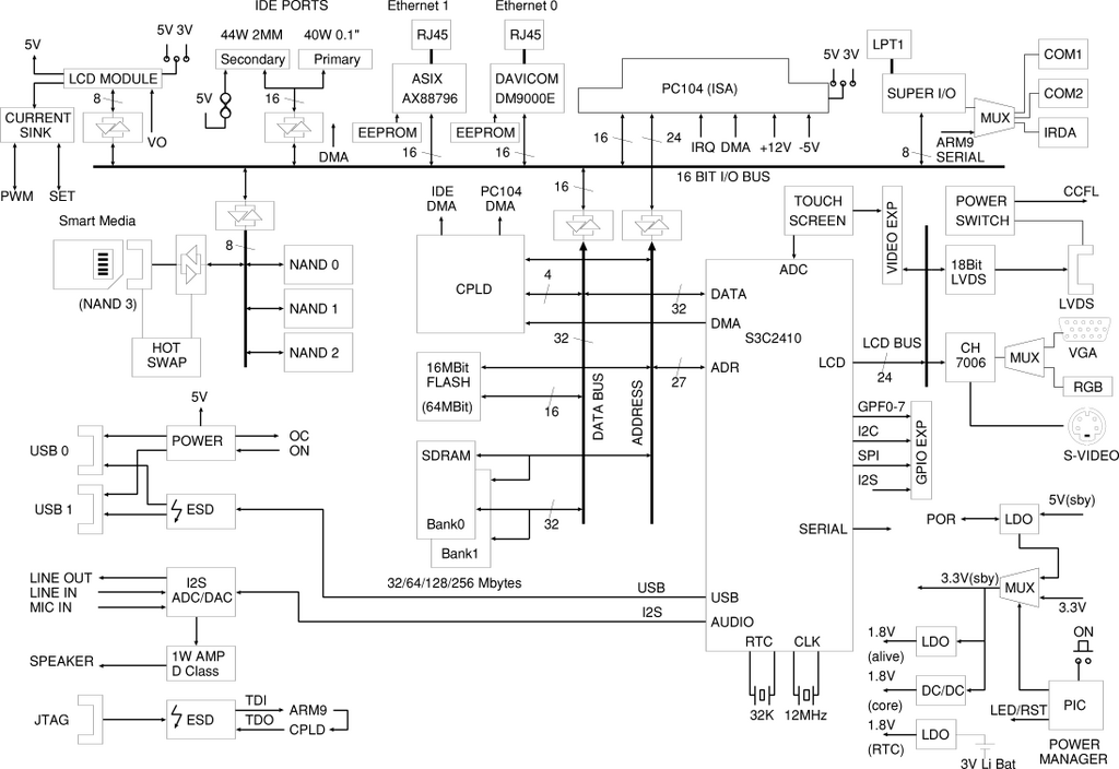

another solution would be havinf ATA interface in the memory bus:
http://www.simtec.co.uk/products/EB2410ITX/
this design implements IDE by a FPGA or actually CPLD, a kind of bunch of GALs/PALs :
http://www.simtec.co.uk/products/EB2410 ... ck-med.png
then question is: how to implement ATA (or SATA for that matter) interface from 32bit address and 32bit data bus running at 100MHz or less.
