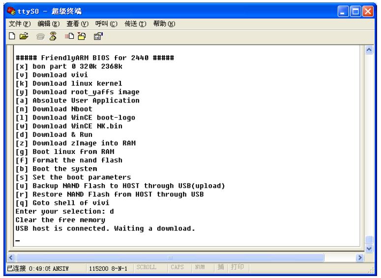

if supervivi downloads the wince image to RAM to do some processing before the result is committed to NAND, then a faulty RAM will obviously be a big problem. i don't see any quick solution other than a "backup" image. i hope esky-sh will not think of my request as too much...

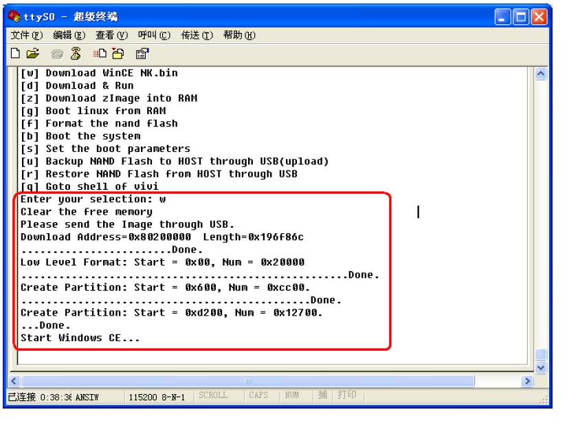

flash wince image to nand
.jpg
flash wince image
.jpg (89.96 KiB) Viewed 10772 times

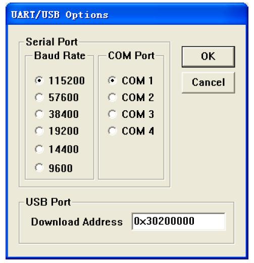

download .nb0 to sdram
.jpg
.jpg (37.91 KiB) Viewed 10770 times

Had you tried your usb downloading on different PCs?
Re: cannot transfer win ce image through USB!!!
Post by esky-sh » Fri Oct 30, 2009 1:47 am
please check and be sure what the nandflash size on your board and correct supervivi version installed -- you can try another supervivi flash downloading on nandflash/norflash by yourself.
