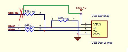

A Hardware Workaround
You can pullup usb enable signal to let the board recognized by DNW when it connected to PC. This will allow latest supervivi-64M work on QQ2440 board.

what do you mean with the red cross?
Disconnect and connect the 5VDC on the 4K7 or do you mean connect also the 5VDC on the front of resistor R29 ?
this is only away to offer rule the signal from the s3c2440 USB_EN.
So the supervivi doesn't give the 5V for this ??? I think its better to solve this in the software manner instead of change the hardware ?
Its little strange for me, but I will try it out.
afther I got the answer on the connect 5VDC with the USB_EN or with out the USB_EN.
Re: QQ2440 image problem
The D+ pin of USB device will be pulled to high when a device connect to PC. On QQ2440 board this feature implemented by USB_EN1 signal(controled by software) but unfortunately latest supervivi-64M ignore it. So we need manually pull D+ pin to high by hardware.
