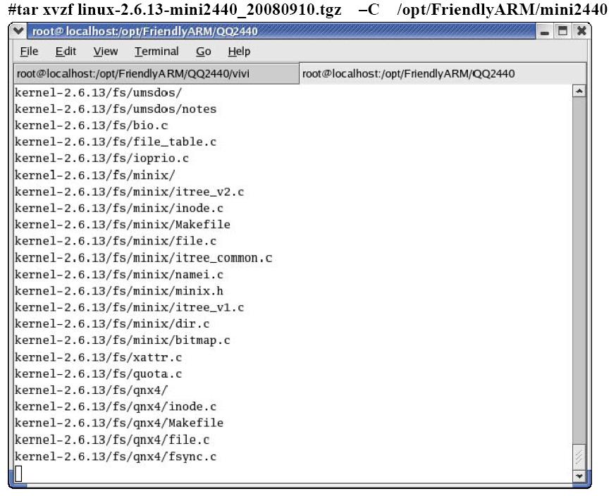

1. untar package of mini2440
compile linux1.JPG (89.99 KiB) Viewed 6149 times

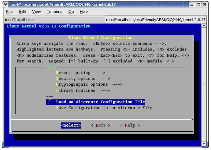

compile linux2.JPG (83.26 KiB) Viewed 6140 times

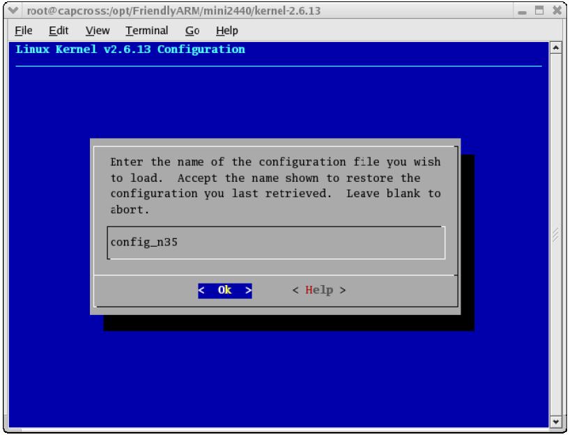

compile linux3.JPG (49.81 KiB) Viewed 6141 times

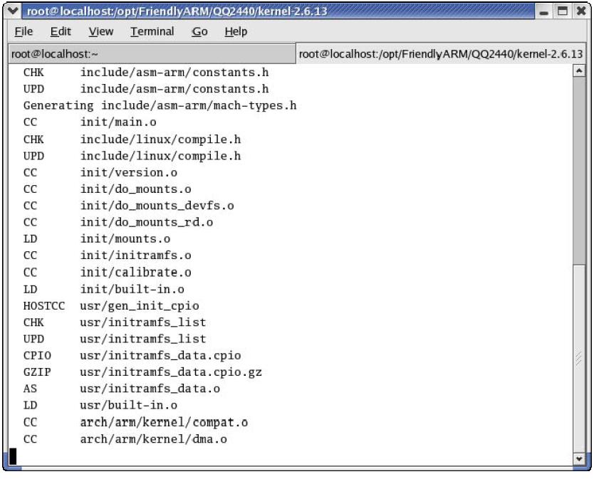

compile linux4.JPG (73.01 KiB) Viewed 6131 times

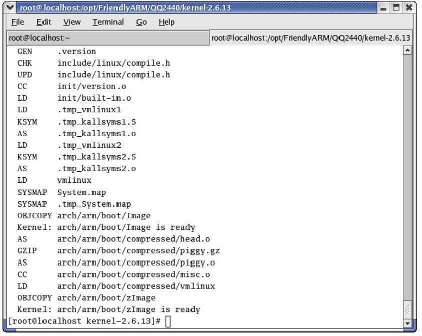

compile linux5.JPG (78.13 KiB) Viewed 6138 times

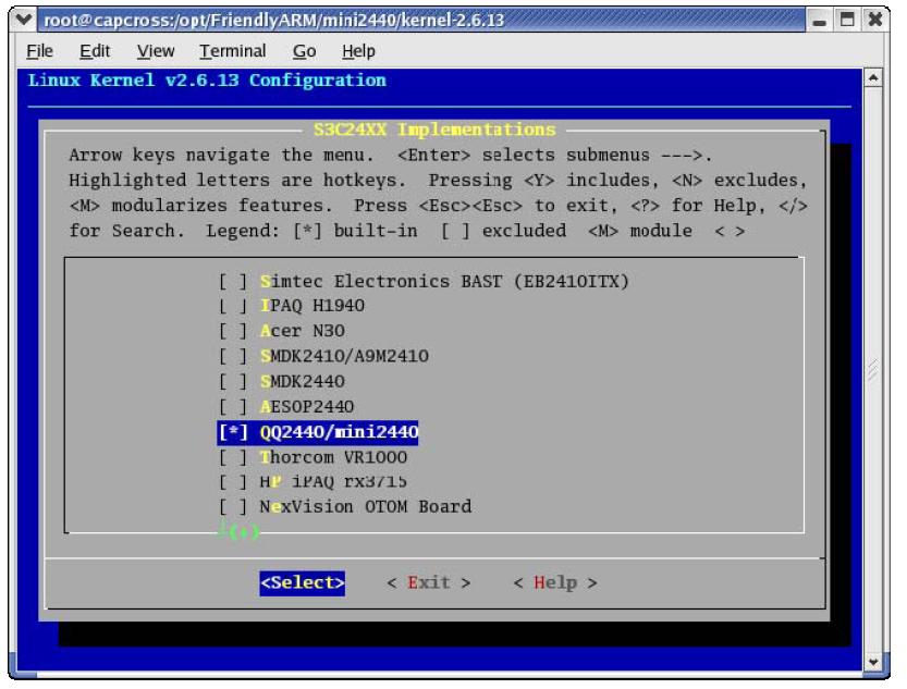

Of course you can customerize your building by menuconfig, e.g. target board type:
compile linux6.JPG (77.75 KiB) Viewed 6131 times
