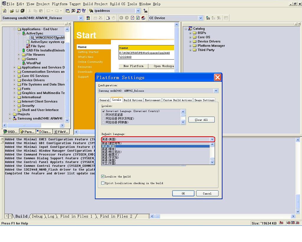

Post by esky-sh » Sat Jan 31, 2009 2:17 am
The button for the kernel language setting in MS PB 5.0 is
Platform->Settings->Locale->Default language
