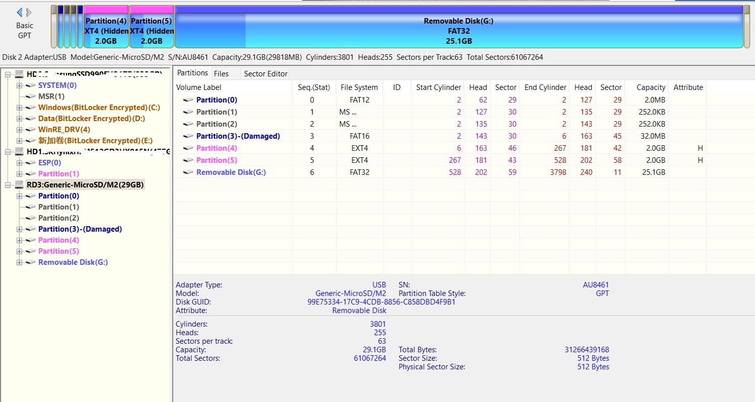

My BeadaPanel 2W is not booting correctly. The display turns on but only the backlight. Screen is black
Tried different cables with no luck.
I went searching here on the forum and found this suggestion:https://www.esky-sh.com/bbs/viewtopic.php?f=30&t=1062
However it did not work. However i noticed that i do not have the same partitions on the device as shown in the guide linked.
Here is what i see in DiskGenius: Image
When connected, it does not show up in BeadaTools
Is there a way to reinstall the software on the SD card or something else i can try?

I attached a partitions layout chart of 2W and you can find it is completely different with the image you attached. So the TF image on your hand is not belong to a Model 2W and you wont expect it will work on your device at all.

  • The image i showed is from opening it in DiskGenius
Fri Mar 21, 2025 8:20 pm
As mentioned i also saw that the partitions do not show as the same on my SD compared to the linked post, so i assume thats the issue. As far as i can tell one of those partitions has linux on it but maybe its missing the boot part or something? I dont know if its a broken SD card or maybe broken partitioning table.
