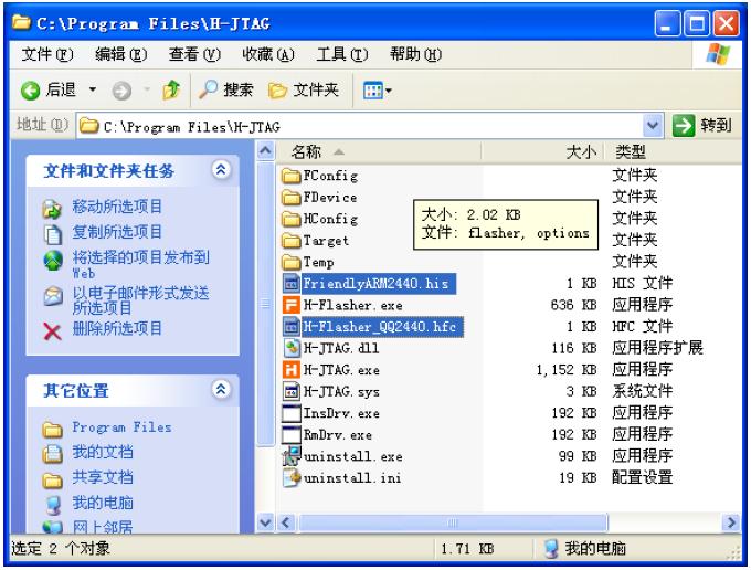

1. Copy FrendlyARM2440.his and H-Flasher_QQ2440.hfc files to H-JTAG installation folder

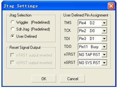

2. Make JTAG Port pin assignment

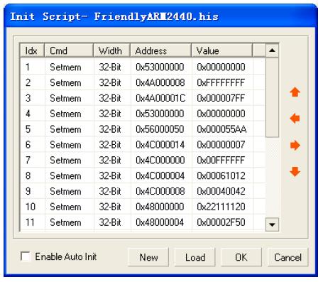

3. Run init script

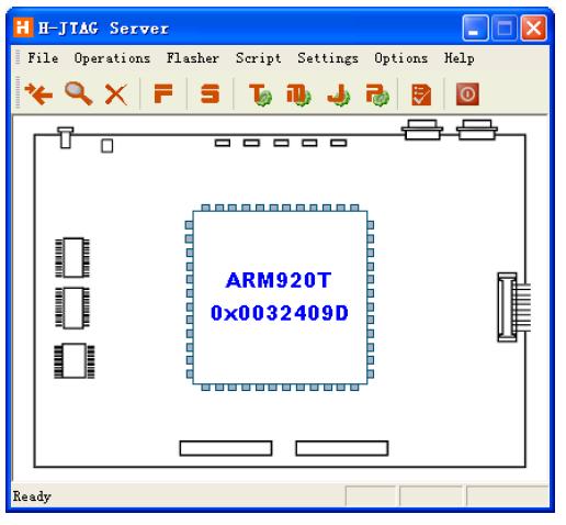

4. Detect target CPU

And there is now such file h-flasher.hfc

I got it to work, but I had to set the H-JTAG settings again after loading the script, it had defaulted to "wiggler".
Also the H-Flasher.hfc does not get installed automatically, you have to manually copy it to the installation directory, the full name of the one I got is "H-Flasher_mini2440.hfc"
