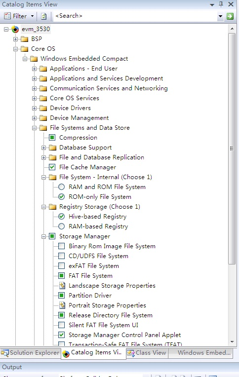

this is our current settings for evaluation image:

Re: Windows Embedded Compact 7 ported on Beagleboard xM
Post by dezso » Wed Feb 01, 2012 9:29 pm
The image you provided last was build with this setting ?!
Look like we have been using ram-disk, "HKEY_LOCAL_MACHINE\System\StorageManager\AutoLoad\RAMDisk"
