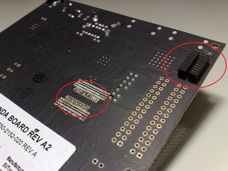

Post by esky-sh » Sun Nov 06, 2011 8:12 pm
1. Add 33 ohm (0201) resistors on the back of the board (R176-R203)
Incase these are not available add zero ohm resistor or simply solder across the resistor pads.
2. Mount J1&J4 on back of the board
Actually solder them on top side.

Re: Pandaboard reworks of connecting to beada frame display
Post by esky-sh » Sat Jun 16, 2012 7:55 pm
it should be on bottom. so you will need to remove the black plastic standoffs.
LARDEUR wrote:solder connectors J1 and J4 must be made on the top and bottom or only just bottom suffice?
